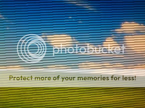

    I uninstalled the driver and it seemed to solve the BSoD issue, I'm currently in normal mode and it's not frozen up or locked on me. The screen is really messed up though, I can't change the resolution and there are black diagonal lines on the screen from bottom to top. I'll try to add a picture from my camera in a second if it's needed.

    I installed the new driver, no BSoD, but the screen is still messed up:
    I'm also unable to change the resolution like before.

    Thanks for the picture.
    Since you installed the new driver and you are still experiencing graphics corruption issues I would uninstall the new driver that you just installed.
    After you finish uninstalling the new graphics driver, shut the PC down and install the new graphics card.
    After the new card is installed, install the driver from the CD that came with the card and hopefully the computer will run normally.

    Welp, that fixed it. I kind of figured as soon as I saw the issue that the card was the problem. It's too bad, because the card itself looks pristine, I took the liberty of cleaning in the case with compressed air every 5-6 months. Oh well.

    Your Welcome. Normally whenever you notice display corruption on the screen and installing a new graphics driver doesn't resolve your problem then most of the time its the graphics card itself that is wearing out.
