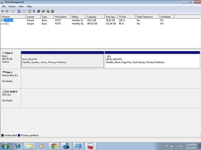

  9. 2015/08/01
    jennmay
    jennmay Well-Known Member Thread Starter
    2007/03/15
    124
    [​IMG][/URL][/IMG]
  10. 2015/08/01
    7,919
    511
    You installed Windows 7 incorrectly. The Operating System partition should be the letter C and you shouldn't have a recovery partition.

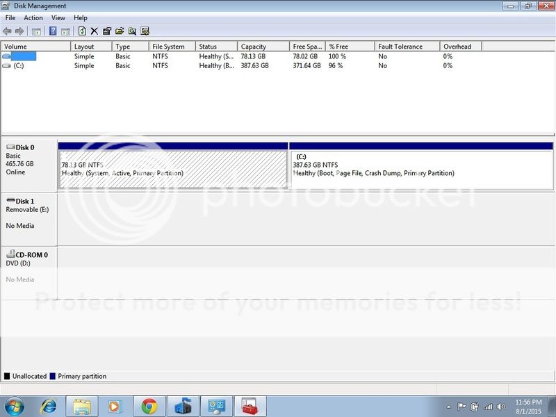

  19. 2015/08/01
    7,919
    511
    That's great that everything is working but can you post a new disk management screenshot so I can verify that the partitions are correct?
