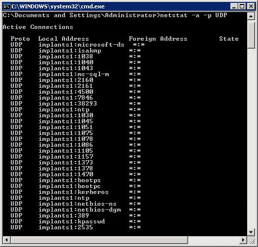

    Ive ran netstat -a -p UDP and theres nothing hogging the DNS port "53 "

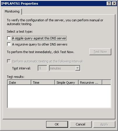

    Can you do this:
    • Open DNS manager
    • Right click on you DNS Server Icon (probably labelled 'IMPLANTS1' and select Properties.
    • Select the Interfaces tab
    Which addresses are set as being listened to, or is the setting "All IP addresses" being used?

    It doesn't have an interfaces tab... Probably because the service isn't running :(.

    However, there could be a simple cause - something else is already listening on the DNS port (53) and the is preventing the DNS service from using that port. Try this:
    netstat -ano
    That will list all the ports being used or assigned to processes. Look for an entry for either 0.0.0.0:53 or 127.0.0.1:53. If there is one, something is already using the port and you need to stop it before the DNS service will start.
    To track down the process, note down the PID as that will identify the process. Then do a:
    tasklist
    That will show you the running executable and tie them to PIDs. If the one you are looking for is tied to svchost, try this:
    tasklist /svc
    and that will show you the systems using svchost on that PID.

    Theres nothing listening on port 53 :eek:.
    So it looks like its just refusing to start :rolleyes:.
