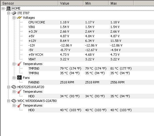

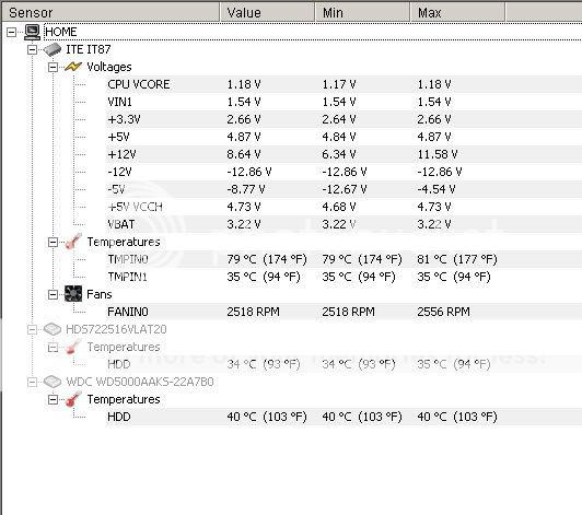

    I must admit to not knowing what these readings refer to - maybe Rockster can fill us in on that, but the TMPIN0 is mighty high.
    Is there no read out for the CPU or the graphics card? (screenshot)
    I see the +3.3v is somewhat on the low side, but ....

  12. 2009/02/15
    What about the CPU??
  13. 2009/02/15
    braindead
    braindead Inactive Thread Starter
    2009/02/09
    265
    isn't the TMPIN0 TMPIN1 TMPIN2 data the CPU temp? (I figure processor 1, 2 and MB)
    the data i posted above is all there is as far as sensor or temp goes.
    does that make any sense?

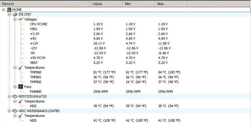

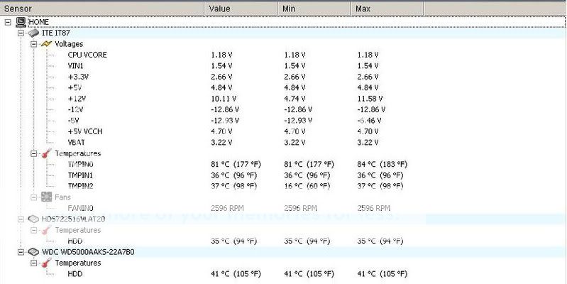

    I don't buy that explanation - if you look at CPUID - Hardware Monitor, which appears to be the same applet as is included in SIW they list .....
    CPU =TMPIN0?
    PWM =TMPIN1?
    Chipset =TMPIN3?
    If my interpretation is correct your CPU is running at 80 odd deg C and therin lies your problem.
    Download and run Hardware Monitor from the URL above and post back with the same screen shot as posted below (from my computer).

  15. 2009/02/15
    braindead
    2009/02/09
    265
    only 2 on this one but same temps
    edit: brb with the ice cubes and fire hose :p
  16. 2009/02/15
    I think it is reasonable to conclude that the CPU is overheating - I am aware that Intel's tend to run hotter than AMD's which I have use for years, but that seems far, far too hot to me and I would expect the unscheduled shutdowns you are experiencing at that sort of temperature.

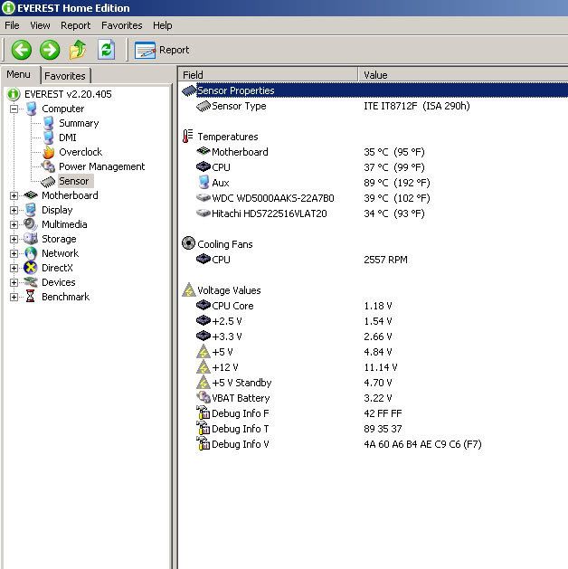

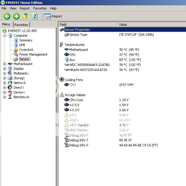

    Let's look for confirmation of that temp using another applet - Everest - look under Motherboard > Sensor in the left hand pane (screenshot).

  18. 2009/02/15

    Those SIW Sensor readings don't tell us much without knowing what semi-conductor is being monitored. There was probably a listing above those that identified it, but there also should be a CPU listing below those and SIW will give one a CPU temperature reading. Just to illustrate this and add to the confusion, here is a listing of semi-conductors beginning with the W8 prefix.
    It would be helpful to get an accurate read on your CPU temp and I'd also agree with Pete re: concern on your 3.3V reading being 2.66V - that's almost a 20% variance to the spec and that's not good. It also brings us full circle as Pete's initial comments focused on the PSU followed by overheating. While in agreement, I put heat first followed by PSU. I guess its academic at this point but Pete's initial diagnosis appears to be right on the money and both problems need attention.

    I just took another look at your posting and I think that is your on die CPU temp. While I was looking I also saw that +12V reading which I had not noticed before - based on these readings, there is a very serious problem with your PSU. Replace it. edit - disregard this - see below
    edit: Something is haywire with these SIW readings from your attachment. These PSU readings can't be accurate and therefore, it would be logical to also question the accuracy of the temperature readings. What version of SIW are your running?
    second edit - get Everest Version 2.20 from http://www.oldversion.com and post temperature and voltage readings
    third edit - Pete also linked to Everest from another site - go to either one and post results after downloading and installing.
