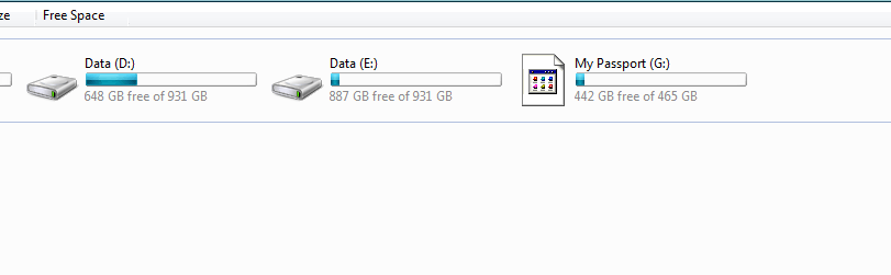

    My Sister Owns a WD passport 500 GB external HD, which she uses as data disk since her laptop HD is only 40GB.
    a few days ago she noticed, the drives icon is missing (in my computer): [​IMG]
    1st thought was to check for viruses, neither AVG free nor Panda online scan found anything.
    then i thought it might be one of the hidden files (desktop.ini, autobat.ini, ...) that was corrupted and needed to be deleted, to my surprise there was none.

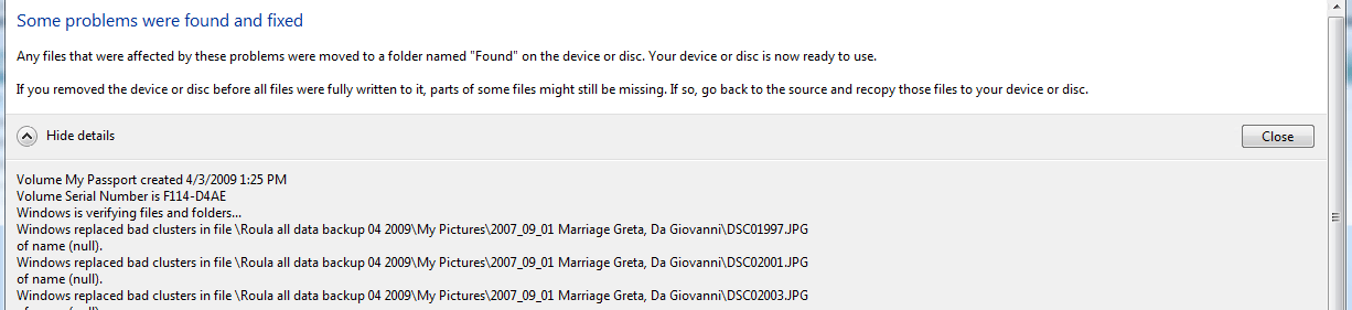

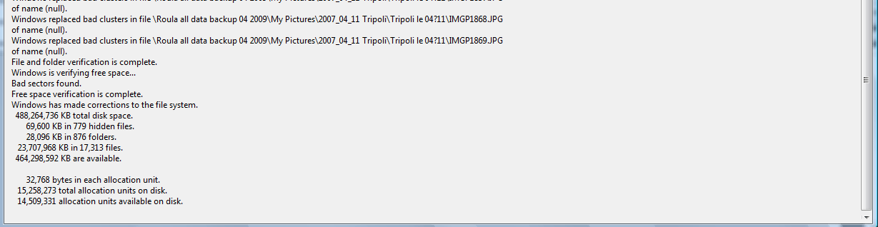

    i decided to back up the data and format the drive, as soon as i plugged to my desktop i got a message saying that the drive needs to be scanned. (there is only 25 GB of Data on it but the scan took over 5 hrs).
    here are screen shots of the report:
    i searched every sub-folder on the drive and could not find the alleged "found" folder.
    there are 46 files (all pictures) in that log.
    even after the scandisk i was unable to copy some of the files.
    although i could view them with Vista default picture viewer:
    im assuming those pictures are unrecoverable.
    also is there a way to find out what caused all those bad sectors? (id like to be sure its user error and not the drive that is a dud)

    The fact that you were able to backup the data should have told you that there was nothing wrong with the drive? and a simple check, checking the properties on the drive, would have confirmed the drive info.
    The fact that the "My Passport" drive showed that the drive had 442Gb of 465GB free, should have suggested and indicated to you that it was still working, and a further simple Run -> chkdsk G: /f/r would have confirmed that all was OK.
