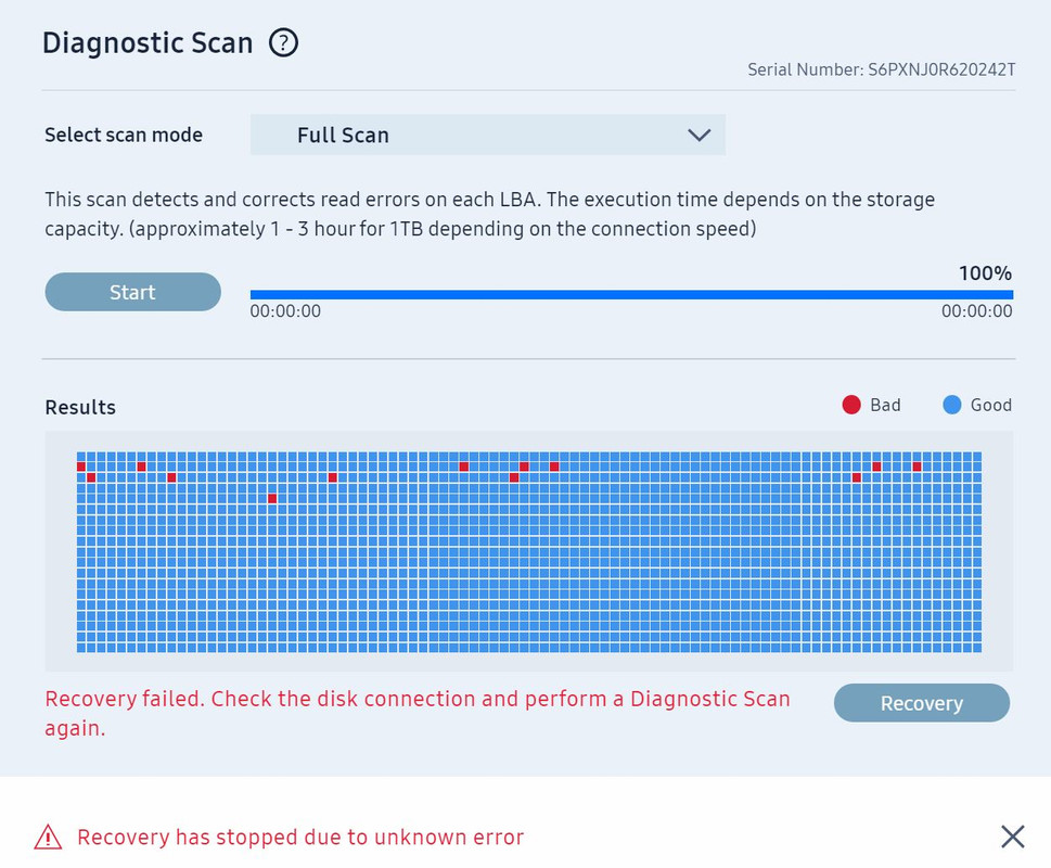

    Magician reported LBA failing. not a bunch. chkdsk is grim. I've backed up the data. [​IMG]

    Unable to locate attribute with instance tag 0x0 and segment
    reference 0x15000000000015. The expected attribute type is 0x80.
    Attribute record (80, "") from file record segment 15
    is corrupt.
    Attribute record of type 0x80 and instance tag 0x3 is cross linked
    starting at 0x92745a for possibly 0x2 clusters.
    Some clusters occupied by attribute of type 0x80 and instance tag 0x3
    in file 0x73ce2 is already in use.
    Attribute record (80, "") from file record segment 73CE2
    is corrupt.
    851968 file records processed.
    File verification completed.
    Phase duration (File record verification): 7.39 seconds.
    File record segment 13 is an orphan.
    File record segment 15 is an orphan.
    27880 large file records processed.
    Phase duration (Orphan file record recovery): 0.00 milliseconds.
    anyway, glad to see SSD's are dime a dozen now

  14. 2024/08/06
    3,372
    Why did you run it in read-only mode? You didn't give chkdsk a chance to see if could repair the problem(s).
    Note that corrupted data is not good. But corrupted data does NOT automatically indicate failing hardware.
    As I noted above,
    Understand the /r switch implies (includes the functions of) the /f switch. So when you enter chkdsk /r, you perform all the functions of /f, plus chkdsk tries to recover readable data.
    And running chkdsk from an elevated command prompt (as administrator) gives chkdsk permission to access to all the files and sectors.
    FTR, if you want to see what all the switches do (without performing any functions on the disk or data), as well as examples of proper syntax, enter chkdsk /? at the command prompt.

    So ended up replacing the drive with an MSI 1 TB. Boots faster. Next stop is seeing what kind of warranty Samsung will offer. Their website sez the 870 EVO is warrantied for 5 years. Mine started failing at a little less than 3. It still booted up before I replaced it
    Thanks all for the comments

    Just wanted to do an update on this in case anybody is interested in Samsung customer service
    A couple of weeks ago, I went to the Samsung website and registered the bad SSD. Last week, I started the warranty process with Samsung. No questions asked, no receipts needed. they sent me an RMA. I take the drive to any UPS store. The people there packed and shipped it UPS RED to Conneticutt from my place in Utah. No cost to me. Samsung received the drive on Wednesday last week, On Friday last week, they shipped me back a new one UPS BLUE and I got it on Tuesday. Absolutely no cost to me.
    amazing service
