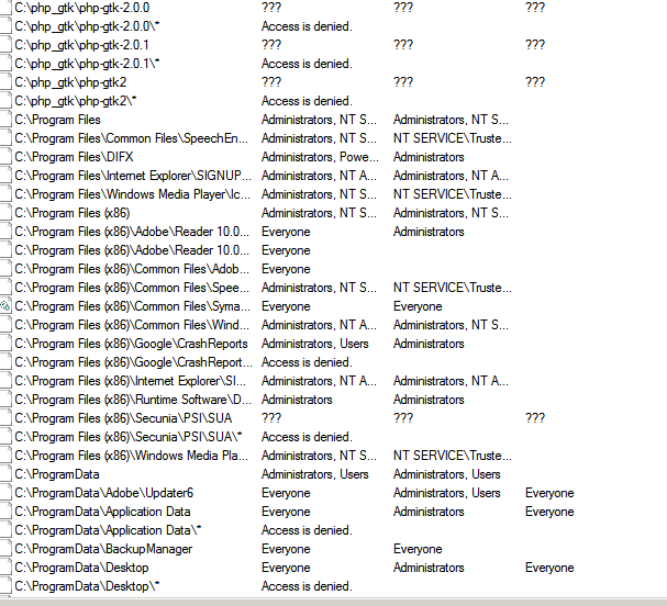

    AccesEnum image (partial)

    You should go ahread with the command shown in the link Evan posted.
    In a evalated command prompt run the following command.
    secedit /configure /cfg %windir%\inf\defltbase.inf /db defltbase.sdb /verbose
    #7
