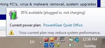

    On the other note, just noticed today that the battery is not charging when plugged in the unit and the AC adapter is on. This is really making me down on Asus. So this is what they meant by 1 year battery warranty and 2+1 years warranty on the laptop.
    I'll still do the updates like you said
    http://i209.photobucket.com/albums/bb215/projectsky/battery.jpg
    regards,
    Chris
    EDIT: No updates available. I got the latest chipset update in the CD. Cant install the Bios as it warns me not to install two files.
    Now, I understand. It looks like I got the hardware defect of the connector of the battery from the laptop or the battery's connector is faulty. But I can access Safe Mode. I'll conduct more test later
