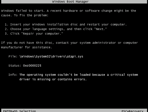

    I have a laptop that won't boot into Windows 10. Dell logo appears and then I get a message - similar to this:
    Windows failed to start. A recent hardware or software change may be the cause. To fix the problem:
    (1) Insert Windows Installation Disk - Don't Have.
    If you do not have, contact ...Adm or Mfr.
    File \EFI\Microsoft\Boot\BCD
    Status
    0xc0000225
    Info: The boot configuration for your computer is missing or contains errors.
    I tried the process to to boot in Safe Mode - Hard shut down three times with timing but had no luck. Also tried instructions from Dell to reset the Real Time Clock but that didn't work. If I press Escape while the above screen is on, I get a settings screen which I think are the BIOS settings. I tried resetting the clock in that menu but it didn't seem to change anything - reset it to correct time. I can't get any options to repair/restore, etc.
    Any suggestions?

    RL - I had already tried the things outlined in your link. The laptop doesn't have a removable battery so I tried to use the RTC reset proposed at the Dell site but that didn't work.
    Steve - not my laptop but they did say it was working fine and turned it on one morning to the "no boot" problem. They said they don't know of anything they did that could have caused it. They are not computer "tinkerers" so I feel confident that didn't try to install or uninstall something that fouled it up. No CD/DVD in the drive. This is the message: I see I can't post the image here as I tried so I will try something else.
    TonyT - Per your link, I downloaded the Media Creation Tool and created a bootable flash drive. I inserted it into the problem laptop, turned the laptop on, and got the same message as above again. The flash drive does blink during the failed boot process. Maybe I am doing something wrong - I hope. I am able to get to the BIOS settings if that helps any. When the BIOS settings screen is visible, one option is "Restore Settings" but I wasn't sure what that might do or cause so I just use the "Exit" option.

    If you got the same error then you didn't boot from the flash drive. Try pressing F12 when booting the flash drive. F12 should bring up the bios boot menu and select the flash drive to boot.

    [​IMG]TonyT - I had 2 options - Windows Boot Manager or UEFI: PMAP, Partition 1. Windows Boot Manager was selected so I toggled to the UEFI option. Then I got to a screen that had 6 options - one being Startup Repair. When I tried it, I got a message "Startup Repair couldn't repair your computer. Press "Advanced" options to repair.........." which takes me to "Troubleshoot" or "Turn off your PC". Troubleshoot brings me back to the 6 option screen. "System Restore" was the only other option I felt comfortable with but it's message, with a red X, was to Restart and select an operating system to restore which took me back to my original problem screen.. Should I try the "Uninstall Updates" option.
    Added Note - At initial boot with the flash drive, there were 2 options. I used the "Repair" option. Should I have used the "Install" option?
    YES.

    Got it going now. I had to go with a fresh install. Wouldn't let me retain the data file while using an installation media rather than the original disc. Will let you know how it goes.
