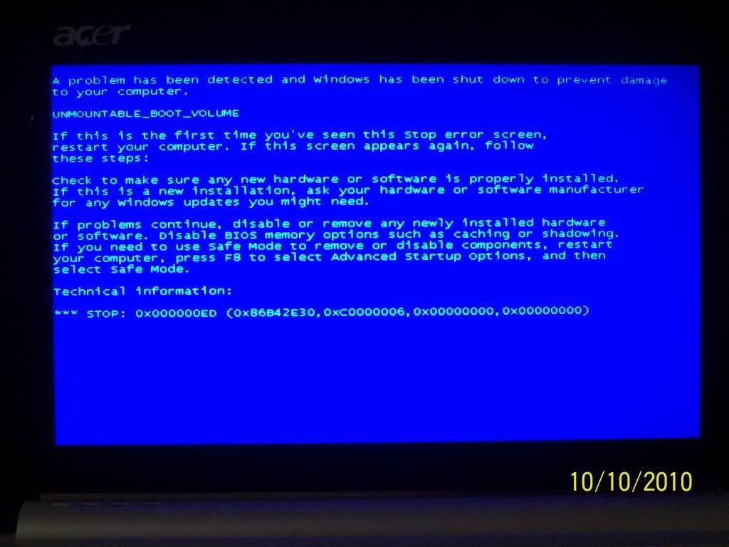

    Hope this helps, did what you said and got it to stay on the blue screen (thank you!) and here is what it says, took pic of the screen hoping it will give a better explanation than I can ;)
    http://i690.photobucket.com/albums/vv266/seashells18/SeaShells/100_7011.jpg

    SeaShells....Thanks for the pic.....0xED usually points to a possibly defective hard drive...the best way to determine that is to swap out another hard drive if there is one available....on a good and lucky day, re-seating the bad drive might get you up and running long enough to back up your data, which you should do if you can....you will eventually need to replace the hard
    drive...... if you have the Windows XP installation disc, it will be possible to run CHKDSK from the Recovery Console, and maybe determine the condition of the drive. This site will no doubt have plenty of how to's about using the recovery console........shout back if you have more questions...
